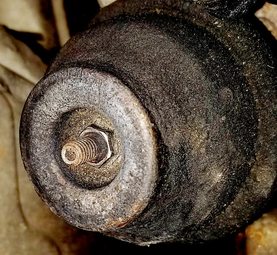

Looking at part of my car that I can not see normally. I think this vacuum diaphragm is the waste gate control (Without a line from the intake manifold.)
So theoretically I should be having maximum boost. No?
Pardon the greeb.
The pic was made with a cell phone against the firewall.
M2 Jetta TD. Northern Missouri

Yes without any boost line on there you should be at max boost unless, someone fiddled with the adjustment on the control rod and has it kinda sorta open. Try putting an air line on it and giving it a shot of air at say 20 lbs and see if the rod moves at all.

I'm not sure that's a barbed fitting on the end of that vacuum can.
Looks more like an adjuster screw.
Could be wrong, it's dirty.

Where would the boost come in on something like that? From the side of the tapered can? Maybe underneath?
Maybe another picture from the end view is needed to decide on that.

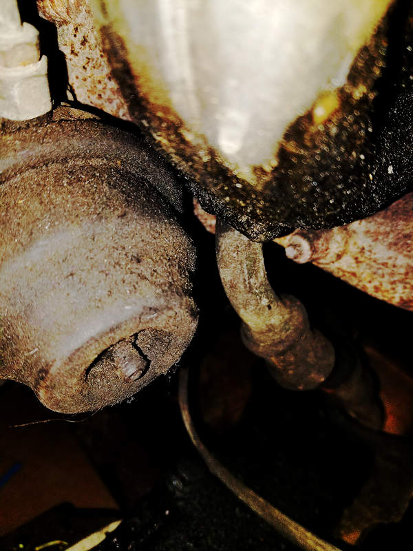

Red circle is the adjustment screw.
Green arrow looks like it is the metal line fitting that runs to the intake scroll and is the boost supply to the wastegate.

I guess they put these controls where they do, to keep us from adjusting them. The pic in Bentleyseems to show a vaccum line at the end of the pot but the intake tube to the turbo has one less fitting.

I assume you are talking about the pic of the turbocharger in the A2 Bentley. That shows the T3 turbo which has the connection as shown in that Bentley pic. You have a K24 or K14 (can't tell from the pic but probably a K24). The K24 has a metal line coming off the side of the wastegate actuator and running to the intake scroll.

Spot on. There is metal line from what looks like on the other side of the diaphragm and goes to a banjo bolt on the passenger side of the compressor impeller, so K24. Thank much.
6mm stud, 3mm hex, probably a 10mm lock nut.
Now to make a tool to fit the lock nut and figure out which direction to turn it to make the boost go up some at max. Has 7-8psi now thinking that 10psi might be where it should be,

Adjusting that is *not* a good idea. It is not an effective way to control boost. Cut the metal line and add a manual boost controller if you want to increase boost above stock.

I have a bit more time now so I thought I would elaborate.
That screw will make a very slight adjustment to the pressure of the wastegate spring but that screw is also the stop for the wastegate valve. You will not get more than 1 or 2 psi of adjustment before the screw has moved far enough IN that it limits the movement of the wastegate valve too much. The result is that you will get an uncontrolled high rpm boost spike.
Instead of adjusting that set screw and messing up the open position of the wastegate valve, it is a much better idea to add a manual boost controller. I prefer the ball/spring style. That style of MBC is adjustable and will prevent the boost pressure from reaching the wastegate actuator until it exceeds whatever pressure the MBC is set to.

Yeah, a pound or two may be fine.
At least I know how much It is turned and can be returned to the original position. i drive this car only every couple of weeks Am going to use it next week so will have a data point.
On the pop-off valve across the intake side of the turbo, I had to turn the screw in until it was seated for one psi going from 7 to 8. turning the same screw out all the way it went down to 6. Putting a plug in it didn't go any higher
The exhaust on my car has a tiny downpipe so am limited at how much it will do.
