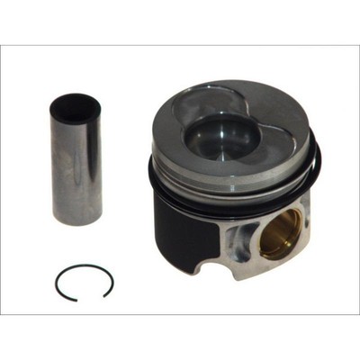

AND FINALLY... The crown jewel of pistons for my goals,
Nüral VW piston #27[/B]...
This was spec for the high output 2004-2009 1.9TDI Polo 130PS (128hp) BLT code engine, as well as the Multivan and Transporter V 2006-2009 84PS(82hp) BRR & 102PS(100hp) BRS code engines.
This has a slightly shallower bowl chamber than the ARL piston, for 19.0: 1 compression ratio vs the ARL @ 18.5:1, the desirable lowered compression ring land positions for keeping them further out of the high heat zone, also designed for tapered small end "Trapezoidal Rods," with oil cooling passages underneath the crown, and again has a thicker overall crown for better heat dissipation & strength.
these would have to be ordered from across the ocean of course since RockAuto no longer carries Nüral Pistons, but as it stands, THIS is the piston for my low end torque + moderate boost & maximum durability goals...
18-114900-45 (cyls 1-2) 18-124900-46 (cyls 3-4) Std. bore
18-114907-45 (cyls 1-2) 18-124907-46 (cyls 3-4) 0.5mm overbore, (& as typical for Nüral, these 0.5mm OS pistons are 0.25mm shorter crown height to allow for block decking)
