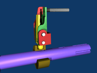

The fuel screw shifts the entire relationship between the accelerator and the output of the pump - IE if you turn the screw in to increase max fuel, you need to adjust the idle speed afterwards as it will have increased.
Huh. Can you explain the mechanism?
Here's a little anim gif experiment.
The red section tilts on the upper pivot and is adjusted by the full-load screw - it moves the lower pivot for the green and yellow sections.
The green section is controlled by the accelerator linkage.
The yellow section is controlled by the governor on the same pivot as the green.
There is a spring between the yellow and green sections.
The control-collar is cutaway to show the spill-port.
(Of course the full load is not adjusted while driving, but its action is shown.)
The control-collar is supposed to be semi-transparent to show the spill-port. :/

If only the second image were the gif.. it'd be easier to understand.

Updated the animation.
