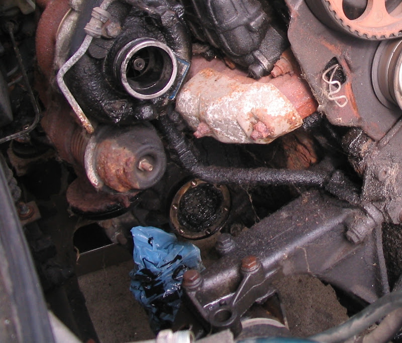

Well, I gave that a shot, and I am not happy. For a good half an hour all I have been saying is " I'm done, I'm not working on any cars any more." " This is bull@$%!, I hate $&@%+?! hate working on cars. I'm going to burn them all to the #&@+#%?! Ground."
And lets just say I really don't curse all that much...at all.
Ok, well after giving it a shot the way I seen it in those pictures, I had to remove the rear engine mount. That went fine, installed everything. Seemed to go well. But as soon as I went to put the mount back on there is no way to get the mount back on. Not enough clearance with the oil line there. So I tried to force it. Well I'm pretty sure I'm going to loose a finger nail.
So I think I need to go back to the other oil pan. But not all sure how well that is going to go either.
Other examples of how these should sit would be great.
I do thank all of you for you help so far.

My two MK2 TDs have the 1-o'clock flange on the oil-pan and the line goes behind the aluminum mount.

theman.. ohhh theman... take pic where yours hits... theman made up plate steel rear mounts for vnt apps.. his may clear your issue..

Yes, originally a N/A, it's a 89. I was going to attempt my other rear mount thinking that it was from a TD but I then remembered it was also from a N/A I just made a line because I didn't have a stock return line.
I've been thinking that they are different but it couldn't be that different due to the fact it would make the engine have an offset in the bay.
 It's closer to clearing at the top then the bottom. The bottom of the mount would really need to be different.

nope, I don't think it would work. I have those flat stock pieces flat to the block. I suppose if it was really thin line it could sneak behind. I welded a JIC fitting to my NA pan at a 45 angle toward the driver side of the car. Custom hose 5/8" ID and it works fine.

So I called the dealer out of curiosity, wondering if there are two different mounts. Turns out the mounts I have are not the correct mounts. The turbo diesel and 16v had the same mounts but it seems the n/a had a slightly different one, but it was weird because when I originally asked about the part he said they should be the same. They even came up in the system the same. So I asked for the part number and it came out different. I told him mine and that looped back to the correct mount that is for the TD and the 16v. He said that the mount must have been from the earlier models but the mount I ended up trying was from a 91 jetta. So I dont believe that all that much. So for future reference the mounts are different.. He guy told me to notch the mount and I would be good.  So that's what I'm going to do.
