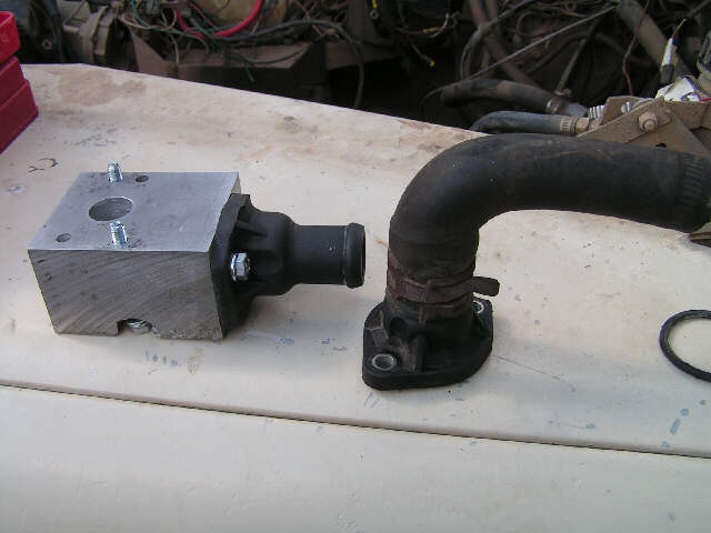

From earlier, to get more boost, put a bleed in the line between the
wastegate and turbo. To get clearance at the back of the head, find a
piece of aluminum, drill 2 intersecting holes at a right angle, drill 2 sets
of bolt holes-one through for the block, and one set tapped for the outlet.
bolt the outlet to one side, then bolt it to the block. I used "the right
stuff" on the block side with no leaks, and the o-ring seals the other
side.
Quote from: speedy
Problem #2:  Water pipe coming out the back of the head extends 2", not including the hose.  Clearance for that is going to be tight.  The back of the turbo is also going to be close to the firewall which could be a major problem.  Won't know for sure until I get it in there.  Fortunately, the adapter plate will move the engine back a little which should help.

Quote from: jimfoo
side.
Jim,
First of all, hats off to you for your conversion!  You are a wild man.  I like what you did with the heater port and the aluminum block also, but I may not even have room to do that.  I got out the straightedge last night and there is about 1" of clearance between the back of the cylinder head and the gas tank.  That means using the divider plate I painstakingly cleaned and coverd with sound deadener is out.  I am going to either have to "customize" the divider with a BFH or make a new divider out of sheet metal.
The temp sender above that port has a spade connecter on it - I figure if I bend it to 90 degrees, I will be able to leave it there and have a few mm of clearance, but that's about it.  I will probably end up using Andrew's idea of blocking off the port completely and Teeing into the port on the side of the head for the heater.  Since my air-cooled bus doesn't currently have a heater, there is no rush and I will probably just block it off for now.
-Dave
