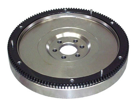

Just wanted to run this by everyone one more time. . .
228 mm TDI FLYWHEEL -
Website - http://www.fourseasontuning.com/product.php?id=931&product_code=028105269b.ess
Vanagon 228 mm CLUTCH AND PRESSURE PLATE KIT  -
Website - http://www.partsgeek.com/catalog/1989/volkswagen/vanagon/clutch/clutch_kit.html
Don't want to be a PITA but - well, I guess I just am sometimes.
Are these the bits required?
The pressure plate looks beefier than what I have now and so does the disc.
Hopefully I can get these on the way and stop bugging everyone with this.

What you need is the TDI/VR6/G60 flywheel and TDI/VR6/G60 pressure plate along with the WBX disc.  I do not think the WBX pressure plate will work, but I'd have to compare the WBX PP and the TDI one to recall why.  I think I have both in the parts bin, but I'd have to look.

The vanagon disc does work with the tdi/g60 flywheel and pressure plate provided you clearance the bell-housing and starter as outlined in the thread I linked.  I'm sure about that.  The only question I have is why the gas vanagon pressure plate doesn't work.  I believe the gasser flywheel is a different depth and the pressure plate matches it.
Reply #23April 05, 2013, 08:16:00 pm
  • 3399
Re: Clutch in van and what is this bolt for?
« Reply #23 on: April 05, 2013, 08:16:00 pm »
I looked in my spare parts bin and it is quite obvious why the WBX PP will not work with the TDI flywheel.  The depth of the friction surface from the surface that the PP bolts to is twice as deep on the WBX, approx. 25mm vs 12.5mm on the TDI flywheel.
Thanks Libby - I am now 331 bucks lighter ;D
