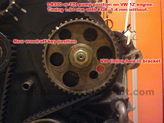

Yes the ahu pulley will work :). But irrc the key way sits 10* one way or the other from vw's shaft. So timing is by hand on the pump as a lock wont fit.
Reply #74October 11, 2013, 09:14:05 am
Re: Vanbcguy's M-TDI Build
« Reply #74 on: October 11, 2013, 09:14:05 am »
Yup, you are correct, here's a perfect example showing how it will be:
http://switchamotor.blogspot.se/2010/08/pump-position-after-tweaking.html
Pretty sure I can live with that - will make getting the belt lined up initially a bit more of a pain but I should be able to work with it.
I suppose I could probably get my machinist to cut a new woodruff key slot in to the pulley too but I don't know FOR SURE what the difference in measurement is.
