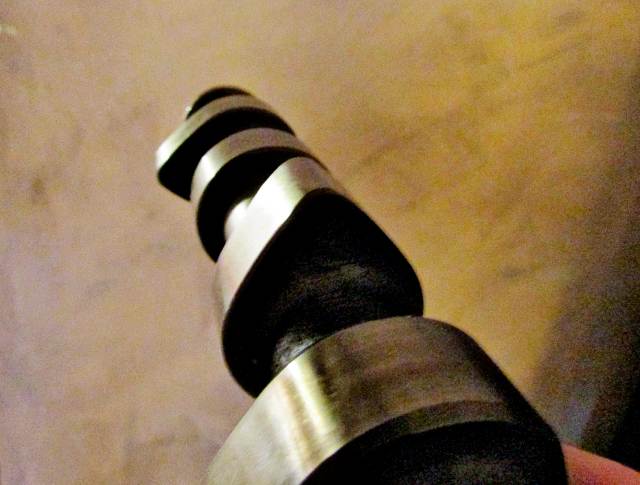

I got my used cam today:
The weather is beyond crap at present. I am going to get a new timing belt and figure out how to install it correctly.
M2 Jetta TD. Northern Missouri

A preliminary measurement: Using a caliper across the peak and then 90deg away I get 8.9 mm (.35") of lift. So I would expect a bit more when done correctly.

I had a bit of time to put the new cam in my lathe to check out some of the specifications.
The cam has a molded in CME and Audi ooooo symbols on it. It was described as a 1.9 industrial cam.
Lobe centers 113°.
Intake max lift of .325" Exhaust max lift .340"
Duration (@ .039") intake 150° (crankshaft°)
exhaust 164°
Duration total intake 230° These are hard to measure.
exhaust 264°
As far as timing I don't have it in the car but probably should be close to splitting the lobe centers. Most cams are close to that. The notch looks to be at the peak of the exhaust lobe.
