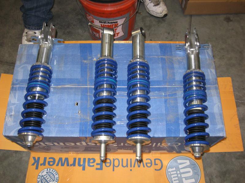

Also finally got around to installing the coilovers. They are JOM, we won them in the BFI contest in August.
We set them to basically half travel for a first shot.
Old vs. New:
Of course Jess wanted to install them!
Before:
After:
Rears are a little lower, will probably raise them up about 1/2" to match fronts.
Teaser shot for now; better pictures later after we finish dialing them in, tuck rear bumpers, and wash the dang car!

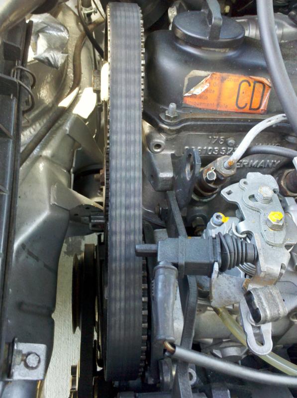

Timing belt is tracking to the outer edge. I can't run with the upper cover on or it rubs. The belt is not walking off any more than this, but I do want to have it track straight so I can put the cover on.
I found this informative post of things to check into:
http://www.vwdiesel.net/forum/index.php?topic=28388.0
Also can report no oil leaking from the oil pan, which is good. BUT, I have a decent leak coming from somewhere in the lower timing cover. Ugh. My mind is leaning towards intermediate shaft seal. Not looking forward to this, but if I have to end up really messing with the IP bracket mounting to get the timing belt to track right, I can deal with this at the same time.
Lastly, have a squeak from something belt driven. I think it may be the alternator. May end up picking up a spare to have anyway, and try swapping.

Have had best luck on belt tracking by leaving rear bolt good and loose and snugging up the front ones first.
Hope the intercooler works out simple.
Did you ever get a quote on the mandrel bent exhaust ?

your timing belt is probably too tight.
81 caddy frankentd 02a, 99.9 tdi jetta, 00 golf
Reply #102April 04, 2011, 11:58:18 pm
Baron VonZeppelin
Re: Klaus, the 84 Jetta TD, gets a rebuild
« Reply #102 on: April 04, 2011, 11:58:18 pm »
truth
If i didn't have the special timing belt tension tool - probably all my Diesel timing belts would be way too tight. 12-13 units is slack compared to a gasser.
One of my most valued tools.
$40 or 50 to the door.
Lemme know if you want to borrow mine by mail, Wolf.

I suppose I might want to borrow that then. If its just a tension issue that makes this all a lot easier...
Reply #104April 05, 2011, 07:15:21 am
« Reply #104 on: April 05, 2011, 07:15:21 am »
most likely not a tension issue. in the my thread you linked, andrew says that an over tensioned belt and worn bushing will cause the belt to track towards the pump.
I mean you can give it a quick check, but I think its the brackets that's your problem.
