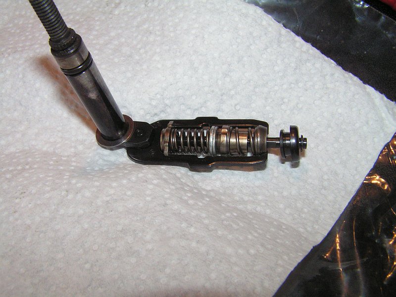

Why is the thread for the mod not have pictures on it, I need pics before I dig into this pump.  I have a 1Z tdi motor with a AAZ turbo pump and need alittle more power up top mine seems to run out of steam..

I was reading the thread on vortex and its very thorough and great pictures.  What I was wondering about was what do you mean by "only shim the MAIN SPRING", your not removing it but compressing it more right?    It shows a thick washer, could you just use a few small ones instead?

It is missing the littlest spring in the pic, but the biggest spring on the left is the main spring. Put 1/4" of washers in it and let it rip. If you shim the other springs you will have driveability issues. If you shim/eliminate the intermediate spring it will have dead spots in the middle RPM ranges and have weird pedal feel on hills. JUST SHIM THE MAIN SPRING AND BE HAPPY :D. Good luck.

Lucas, it looks as though the main spring controls over all fueling? whereas the other two have there own area of fueling?
what is the main springs job in the governor? to allow slow linear rise of fueling? shimming it makes it a quicker rise? What if you go bigger than 1/4"? better or worse?

yes above idle it is the intermediate spring doing much of the work...but you need it to. If you shim it or put a solid piece in it will cause driving issues. If you hold the pedal in one spot and the intermediate spring has a different load put on in *rolling hill for ex.* then your rpm will go up then down without moving the  pedal at all. It feels like you don't have a direct connection to the car it does what it wants. I suspect the firmer the intermediate spring the worse it would be.

Main spring is the high RPM cutoff, if you're trying to raise your fueling cutoff it's the one you want to shim (or even better find a stiffer spring!!)
Intermediate spring makes the car driveable.  Without it you'll have a REALLY hard time driving the car.  Its total movement is practically nothing compared to the main spring too so it really isn't "limiting" anything.
During normal driving the Intermediate spring is what is controlling the car - you NEED it to though.
