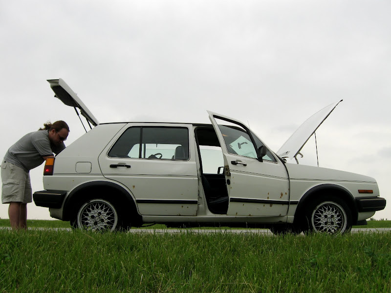

It's not running too bad right now.  We actually cleaned the car up, and shined the paint up as best as we could in preparation for our annual "Cincy" Scirocco gathering the first weekend in June down near Wilmington.  I had turned the fuel up a good amount (remember, EGT's are still high, boost is still very very late) so that I could keep up with the Sciroccos during the cruise, strangely enough EGT's didn't go up at all during highway driving.  They will climb very quickly when your foot is on it and not in the boost.  But the boost comes on a little earlier now, (but with a lot of smoke) and peaks at about 15 psi.  Not great but not too bad.
We estimated about 54 MPG during the 350-ish miles during the trip.  (speedo-odometer still not working) and the car got a lot of attention at Cincy for being a "kia".  (at Cincy, anything that isn't a Scirocco is a Kia and has to park in the Kia section)
A pic, after I blew a boost tube on I-71 on the way down:
Still lots of work to do on it.  I'm not happy but at least my Wife can drive to work.  :P
