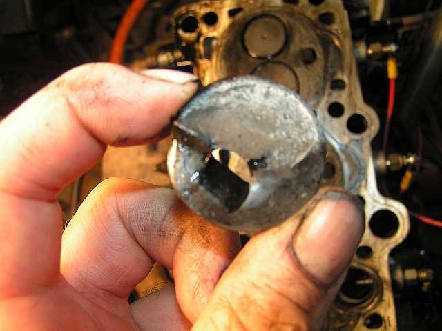

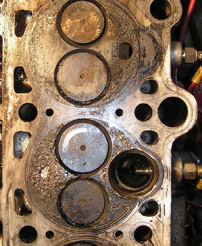

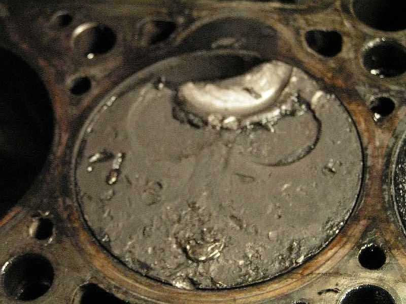

Ummm, here is what happens.

yes they DO drop  :oops: ... hit valves / pistons / head  ....     then its replace the head / that piston / HG  / timing belt / valve cover gaskets /  ETC     ....
