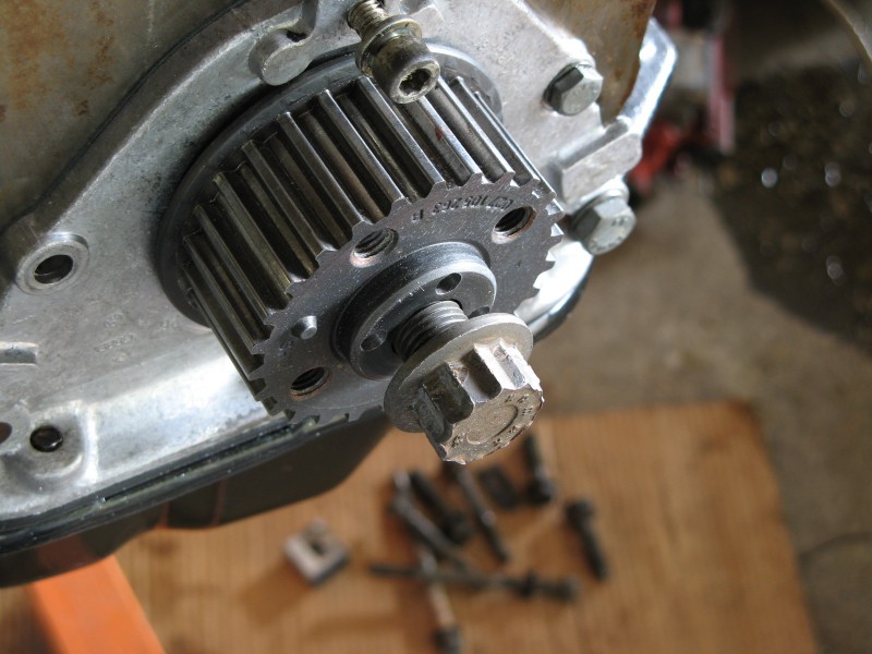

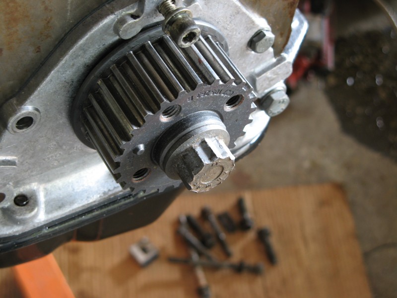

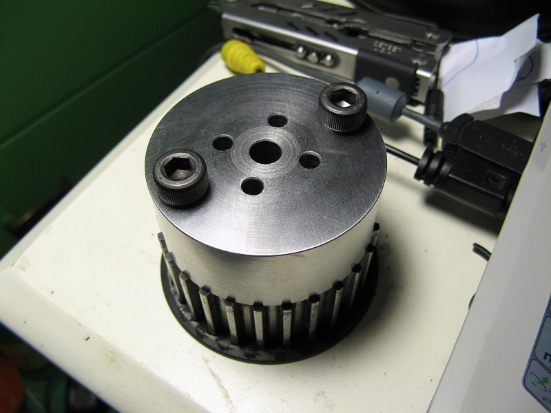

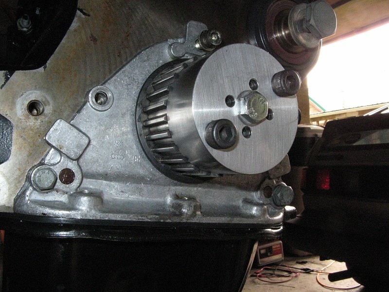

I also have a little more detailed explanation written up in this thread here:
http://forums.vwvortex.com/zerothread?id=3409003

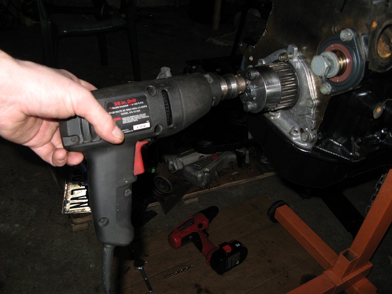

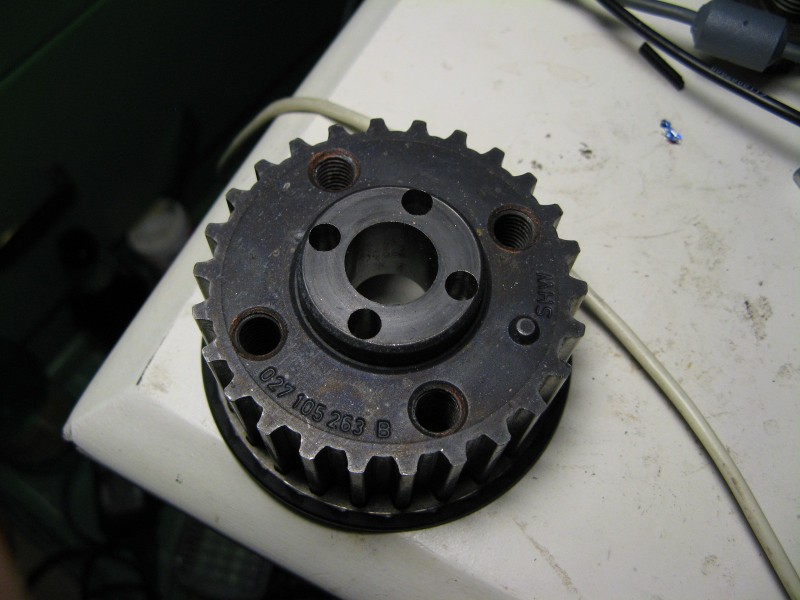

Here are some pictures of the jig just being used on the cog/sprocket:

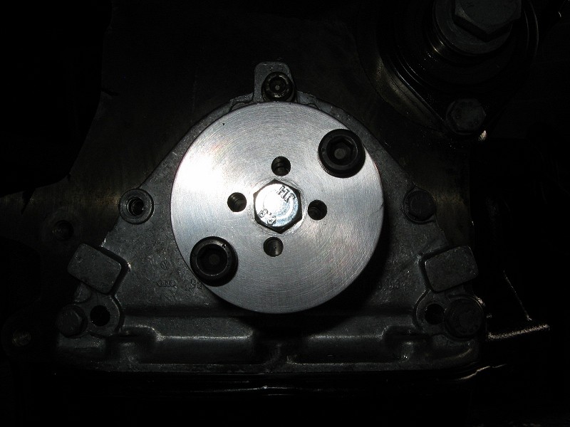

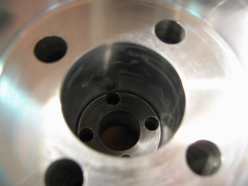

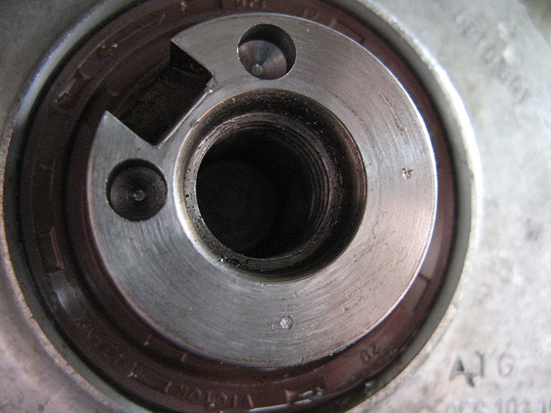

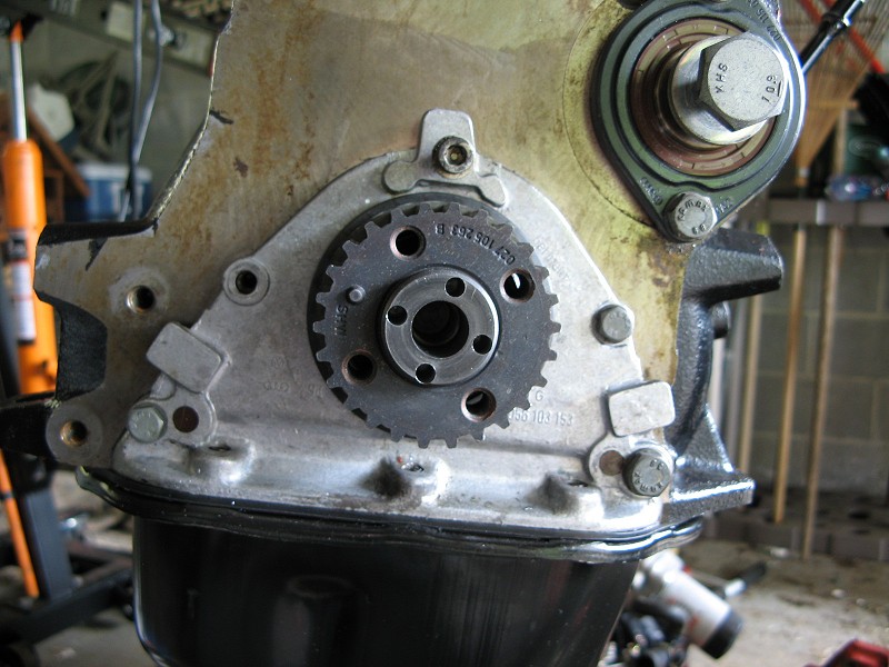

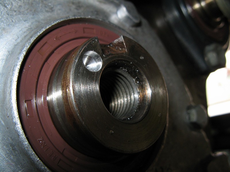

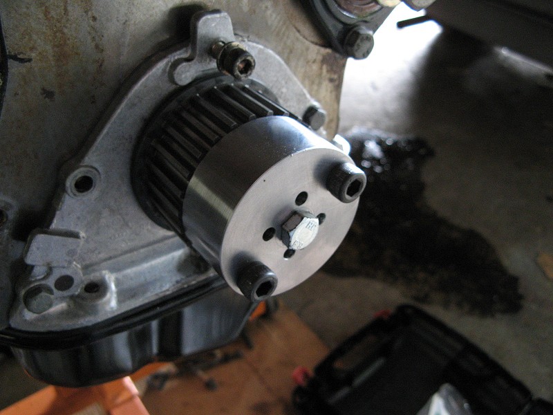

Updated...got two of the four holes drilled.
« Reply #3 on: April 17, 2008, 01:13:33 pm »
Exciting business this is. Not only does it work in theory it works in practice as well.  I'm quite pleased I didn't have to take this thing out to put it in a mill.
Here are some pictures (again, they can be found on the link(s) provided above):

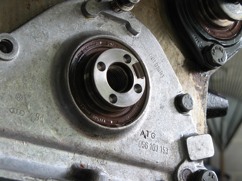

complete success.

and those 4 holes won't weaken the crank nose too much???  looks really interesting... that thing isn't going anywhere!!  :lol:

Quote from: "jtanguay"
The holes are 5mm deep and the material for the crank is one hell of a lot harder than the cog.  Thats less than 1/4" deep.  Now I can't say this for sure because obviously I haven't driven it around yet but my educated guess is it will be just fine.   The thread for the crank nose starts at about 7mm into the crank. So as far as that goes it shouldn't weaken the mounting.

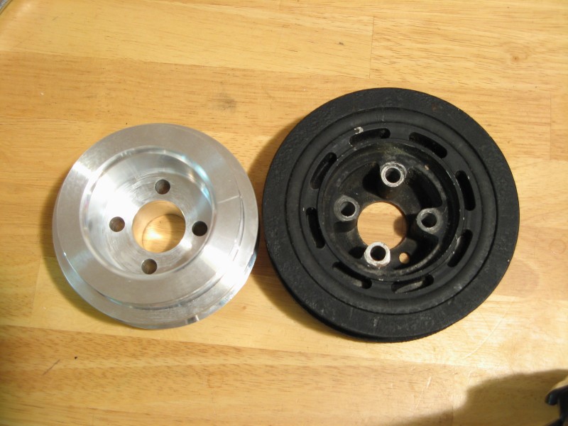

Well the problem is I can't.  The TDI (and the like) use a different style belt that isn't compatible with the 16V and it wouldn't have been as cost effective to do that either.  Sadly I can only design, I don't have the tooling to manufacture so it required dinero $$$.

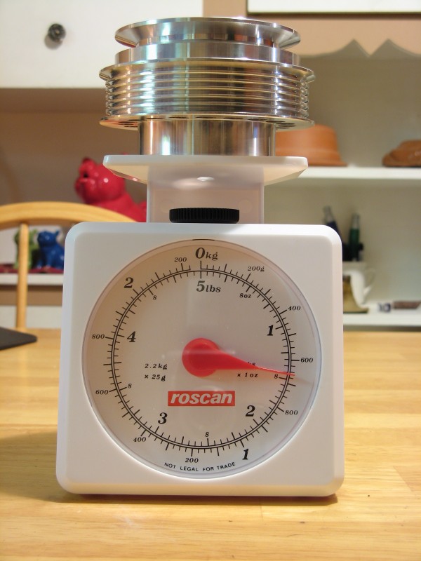

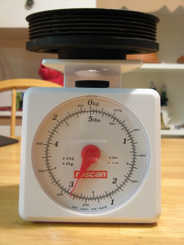

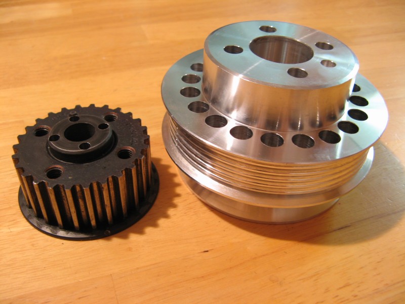

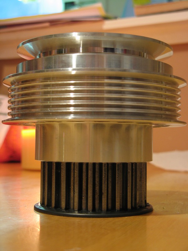

...I thought of a better way of approaching the issue. Part two of the solution as a whole really.  The second part being a lighter "harmonic balancer" thankfully those DO exist in forms compatible with the 16V.  This setup is approximately 51% lighter than the stock pulley.  Since I'm not running anything but the stock load (electrically speaking), and I have no P/S and/or AC, the diameter of the pulley "harmonic balancer" shouldn't matter as much as it would in say those systems.
I posted some pictures on VWVortex which I'll just include in this thread here:
