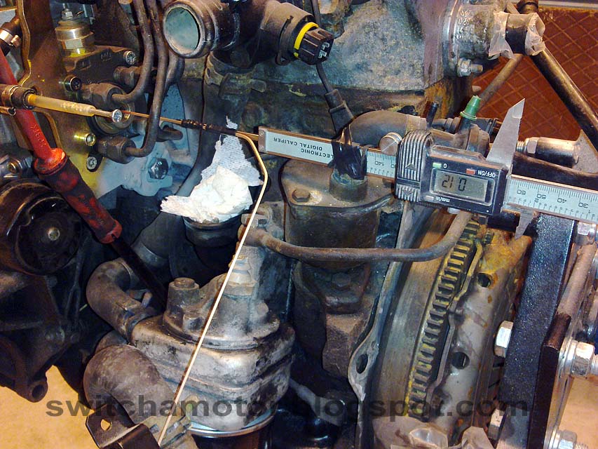

I did put my pump -180 and it didn't run at all.
Do you have any digital calliper? That's what I use and it works really well. I extend the depth measure stick and and fix the calliper by the vacuum pump with a piece of tape. :)

Hi Svenakela,
like your style! Couldn't do that on mine, its very crowded in that area. Im had to buy another adapter, so Im just waiting for it to arrive in the post.
