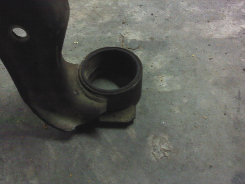

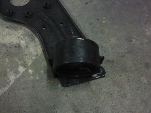

I've searched and found some discussion on how frustrating it is, but never a good picture of someone's bracket in the press showing what they did to get these fetchin motor mounts pressed in and out. I spent some time up at school on our ancient press with very little success. I think that an "L" shaped piece of steel that you could bolt the motor mount bracket to so that the actual motor mount sleeve was in line with the direction of the press instead of being off by 30* would be fabulous... unfortunately I have no welding equipment, materials, or skills. So I'd like to see what you all have done.
Here is what I had in mind...
Passenger side motor mount;
BELOW: the green square is where the "|" part of the "L" shaped bracket would be and the blue line is the "_" part of the "L" and would be coming straight out at the camera. The Green, Yellow, and Red dots are the factory bracket holes I'd use to mount the factory bracket to the "L" bracket for pressing. Green = ok to use, Yellow = might work (if it doesn't interfere with pressing), Red = won't work.
the MSpaint sketch didn't work out so well so I might go make a cardboard template to better illustrate my point.
The reason (I think) the Red one won't work.
Driver side motor/trans mount Ideas for this side?;

Holding the bracket off to the side like that will likely cause the bracket to deform or even tear. You need to support the round part from underneath, inline with the pressing force, with clearance for the motor mount to pass through when it pushes out. With a hydraulic press, that means you might need a 15" long section of heavy tube so you can clear the rest of that bracket.
I was dead-set on using my C-frame ball joint press but didn't have the materials on hand to make the necessary support and "pusher". I ended up cutting through the steel shell of the mount and it popped right out.

Bentley has a nice image of someone using a hack saw set into the mount to cut the outer perimeter. Sawzall works just as well, just watch how deep you go.
Installing is still press fit, and a PITA. I often end up deforming the new mount a bit to match the deformed bracket. I also often grind the edge down a bit to give it more of a tapered edge.

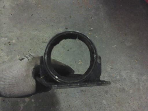

Well, after trying to create something that could be used repetitively and easily (maybe as a service to forum members), It definitely is easiest to just cut out the rubber and then cut a relief slit in the center ring with a Sawzall (being careful not to cut the bracket itself), then use a mini-sledge and center punch and the ring basically falls out (compared to no relief cut). After that, tapping or pressing in the new motor mounts isn't that difficult. I used a vise, a sacrificial piece of square tubing, and a mini-sledge. As an afterthought I probably could have used some wheel bearing grease, or assembly lube to ease the tapping in process.
Hopefully this is a more definitive answer to anyone who's preparing to replace their motor mounts soon.
