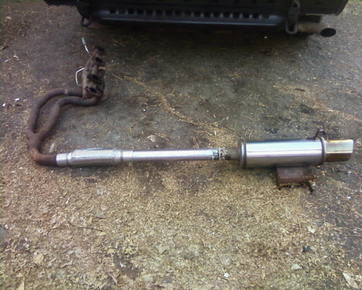

I could make a cool header but this one will do for now-
8v 6 bolt dual mani, looks nice for flow (don't know what it is off of originally).  The pipes are solid, so I'm going to use 'em.  The magnaflow I got for $20 off of a young Honda owner who said it wasn't LOUD ENOUGH for him.  I have it hooked to my single pipe mani now and it is kind of loud, so maybe I'll add a resonator when I can find one (but I love the tone :D ).  I just have to hoist my engine up a little this weekend to pull the motor mount to get the header/ pipe on, and weld a bracket to the end of the pipe so it doesn't wag itself to death.
Maybe I am overthinking the intake.  I am still interested in harmonic intake design principles though.  And most stock intake manifolds, while good, and some are very good, don't fit on vanagons.  I don't mind cutting on my bus if it helps, but it should be worthwhile.
