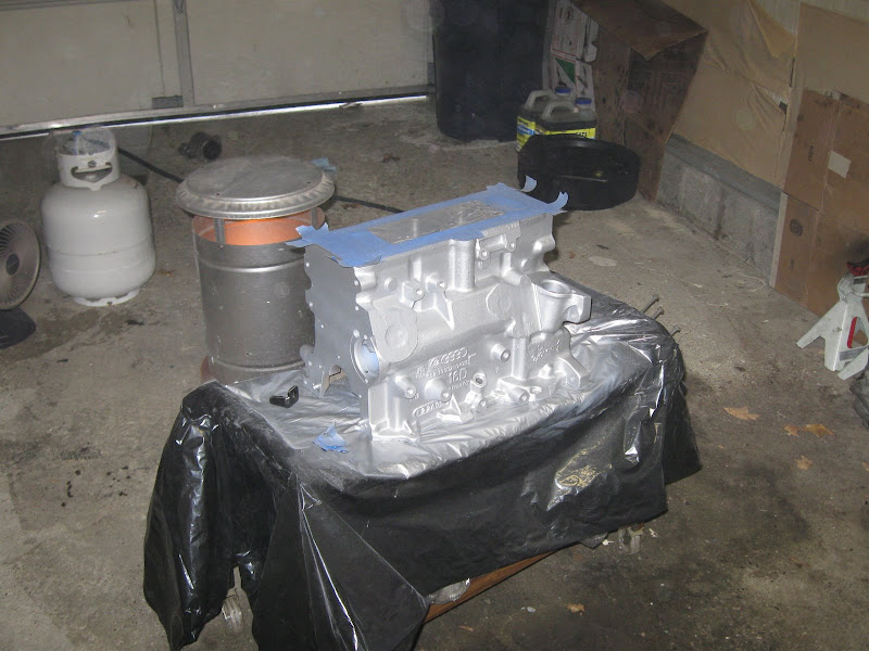

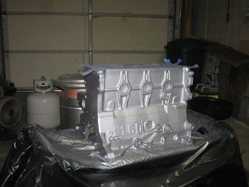

With the help of a propane-fired heater, I got the job done without freezing to death, although space was pretty tight.  :P  So the other day, I decided to push the Scirocco out and paint up the block and brackets/pulleys that have been bead blasted.  I think it turned out pretty good!

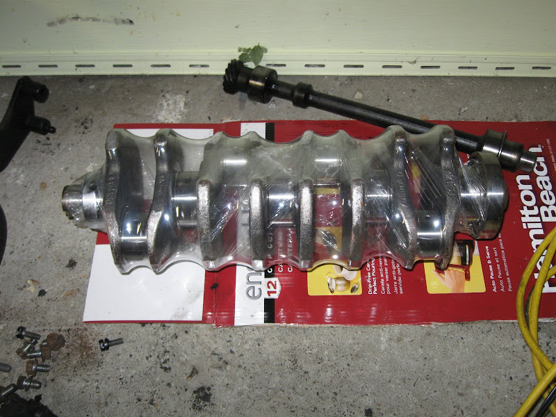

Crank, freshened up and still in plastic:
Das block:
(It was dry in these pictures, so it's a little brighter than I thought it would be, but I think it will look ok once all of the accessories are on it.)
