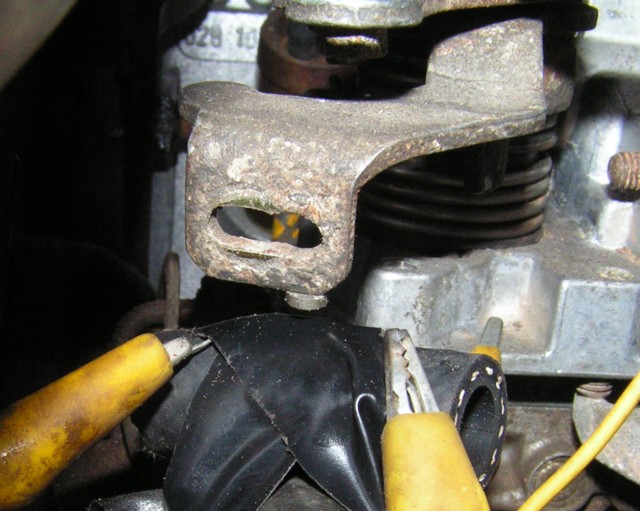

I made my dump valve and screwed around with it for a bit. It would dump down to 6 psi with the only weaker spring I could find that would fit. It would still surge a bit although some of that could have been due to the actuation point of the switch. So I worked on the spring a bit so it would have less force, and tried again. This time the spring was weak enough that it would open the wastegate at 15 psi just from pressure on the valve alone, with nothing going to the diaphragm. I also changed the switch, so it would open the valve to the diaphragm sooner. No surge this time! Then I decided I better hook up the actuator for the vane control as it was getting no boost. With the engine getting revved a bit and the vanes closed, the actuator came down and opened them, like it was supposed to. I decided to disconnect the solenoid to disable my dump valve and see what happened. Well, with the actuator working, I no longer got surge as it wouldn't let the turbo build up as much pressure. Guess I should have hooked it up before I wasted my time making the dump valve. The only good thing is all my plumbing is still in its design phase and made out of ABS for easy and cheap modification. Anyway,
for reference, here are the pics before I take it all off.
The wastegate dump valve.
A small reed switch, which is controlled by the small rare earth magnet on the pump lever.
