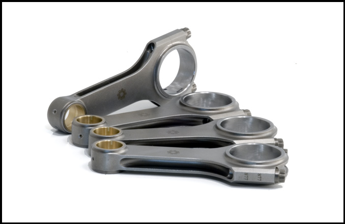

if money is no object $600 will buy a set of rods that are very nice
for an engine with a 4000 rpm redline

Yeah, and if you need stronger rod bolts, chances are you need stronger rods, so just get the Rosten's.
