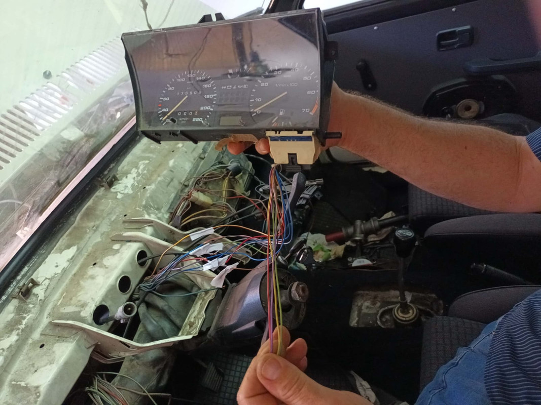

upload images
this is my golf2 petrol  speedometer with 28 pins

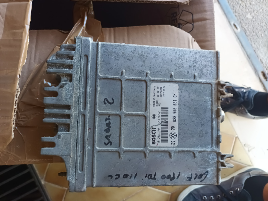

This is the ecu of my tdi.
I also have the alternator signal W available.

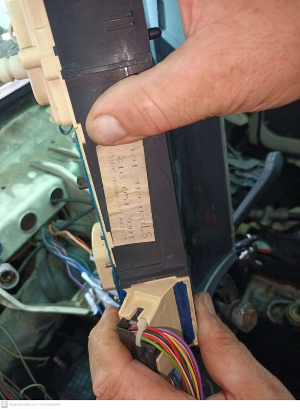

This sticker is under the speedometer, could it help?
Thank you so much

I think the MK1 GTI cluster is a better place to grab a tach from.
 It bolts right to the back of the cluster, easily swaps in.
 Here's a thread about converting a gas tach to diesel, MK1 and MK2 boards:
https://vwdiesel.net/forum/index.php/topic,3741.0.html
