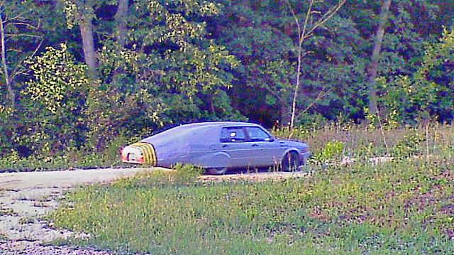

Most of the "aero" benefits are at the back of the vehicle. But some are available at the front. Blocking off the grill helps. I have about 3/4ths of the radiator covered. Narrow tires help. Putting spats in front of the tires helps.
Look at almost every newer SUV and van, they all have a rear window deflector. Its purpose is to help the air stay attached longer.  I have a 12" long deflector on the back window of mine.
Taking it to an extreme, this guy gets 60-70 mpg on his diesel. Besides the obvious he has a full underbody covering and a nearly full grill block.

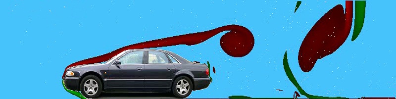

Perhaps y'all are familiar with Flow-Illustrator? It makes videos online, or a version of the program can be downloaded.
http://www.flowillustrator.com/
Not a 3D flow modeller, but interesting.
