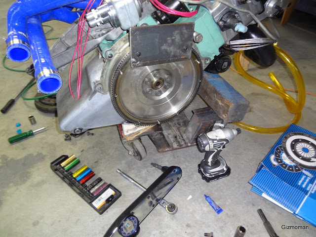

There's still quite a bit to do on the project but I'm hopefully getting the engine in today.
The new larger flywheel installed with new bolts. Loctite red and torqued to spec using a fancy locking tool :)
Pressure plate installed and one of two tabs hammered flat (thanks for the info libby). I did the other as well.

The bell housing and starter tip may still need a little clearancing for the pressure plate.
