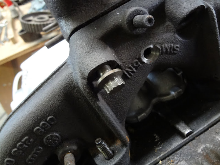

I'm slowly fitting the bits back together and found that the block heater on the block I bought (from a great guy on this forum) would be tough to get out - so I modified the fabricated motor mount some more.
First question, is this a good heater to use or are there better/worse ones? This one was coated with silicone. Not sure if that means it was leaking, or the PO just wanted to make sure it didn't. Second question, is a sealer required - all there is to seal it is an O-ring. The bore is in good shape (not pitted) but I kinda don't trust it either. It does fit quite snug once it's in there though. I've no experience with block heaters and would appreciate any advice from the cold climate folks.
Also, if anyone has one or two spare 12 point bolts that hold a K14 to the exhaust manifold, I'd be happy to buy them as I'm missing one. They are 10-1.5 x 46 mm.
I may resort to replacing all four with grade 12 SHCSs but I like the way these torque up and they have a nice flange on em as well.
In the photo above you can also see the new 1/8" EGT port. The lack of that is why I'm rebuilding the engine (no EGT to sense I was cooking the #4 piston) ;D
  • Block heater sealing
  • 12 point 10 mm K-14 turbo bolts.
Any help appreciated - thanks.

Ill haveta post up some pics of the 1000 watt 120vac kim hotstart tank heaters we use on gens. Its a little large about the size of a 20 oz plastic coke bottle. Id like to use one but its a little bulky. It has a snap disc tstat built in in wide ranges of temps. The freeze plug ones are ok but i use sealer cause i dont wanna have to drain it down if it leaks. These heaters we use would work on a small v8 and hold 100-120f on the coldest days
