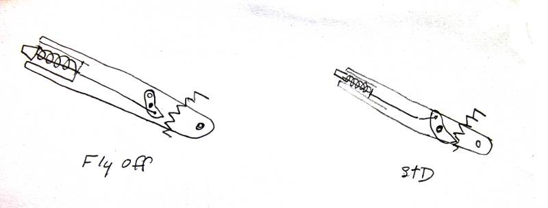

For you guys serious about rear wheel steering. Be able to turn around in your own lane. Of course you can always use the hand brake without mod but you need to keep your thumb on the button 100% of the time.
Here's a simple drawing on how to convert your emergency brake to a fly-off.
Basically you take out the paw, rebend the control rod, drill a new hole in the paw. Reassemble.
I haven't done it on my vw yet.

PAWL...
