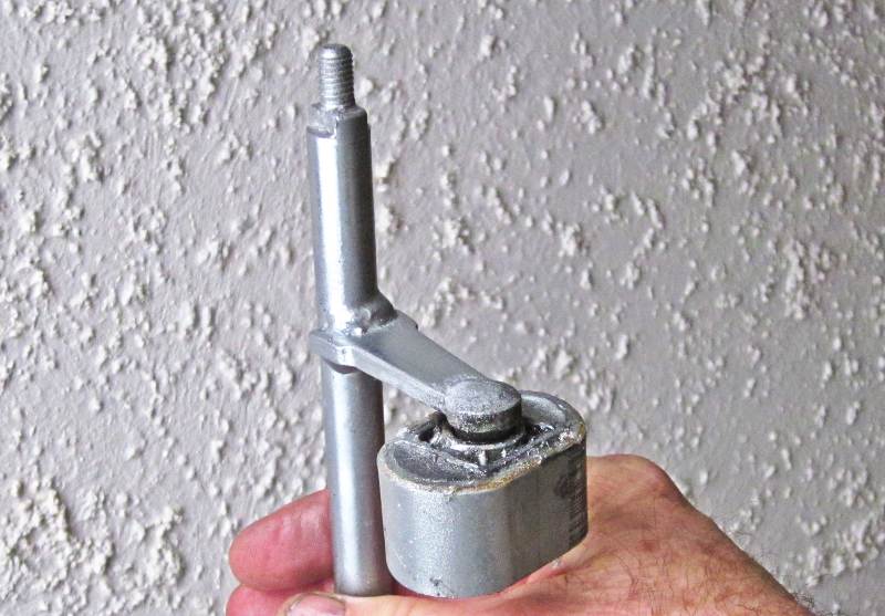

I really appreciate the advice on the part. I didn't happen to have one handy,
If I had a ball, I would have just fit it back on the stock arm.
I scrounged around and found  that I had a chunk of 1" square steel tubing. It fit pretty tightly over the old worn ball. It helped but still had about 2" of fore and aft play. I looked around and found some 1.25" pvc electric  conduit so I decided to reshape it to fit over the square tubing and to fit snugly in the shifter arm. I had used shoe goo adhesive to hold the parts together. I really like it. It's tuff and durable.
The "ball" now is 1.25" thick.
At any rate my shifter now is pretty good. It has about an inch of play in any gear. I don't have to hold the shifter in reverse any more.
I think I will look around for a roller bearing with a 1.25" OD.

Been driving the car with the homemade transfer ball. Seems to work a ton better. I was having trouble keeping it in reverse and was slipping out of 3rd. All is well now.
I have about 3/4-1" of side play when in gear and about 1 1/2 -1 3/4 of front to back play. Not truly precise but decent.
