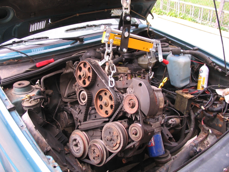

As easy-peasy as described. I already had the radiator & condenser out, so the rest was a treat.
Having the radiator & condenser out made the job super easy. The lift did not need to be very high. The HF hoist is adequate and the cheap leveler is dicey, but very helpful.
    Hoses off
    Cables off
    Exhaust off
    Intake duct off
    PS pump & bracket off block (hoses still attached to pump)
    Axles off (at the flanges)
    Shift linkage disconnected at the link-rods
It took me about ten minutes to actually lift the engine out.

Also chose to do the rabbit from underneath after reading around.  I yanked the radiator quickly just in case as well as alternator because Im replacing things.  Then I jacked engine up to get rear mount out, took whole front bracket off, then with side mounts bolts loose the engine will just drop as you lift the car.  I layed engine down onto a big wardrobe box on concrete floor which made for easy sliding later.
I used the harbor freight hoist attached around each bumper mount and raised the car.  No problem and it didn't have to go as high as I would have thought.  Then I spun engine 90 degrees so it would fit inbetween my hoist and pulled it inbetween its legs which gave me enough room to lower car.  Then just hooked onto engine to get off ground and could roll it away.

I took the MK1 engine and transmission out the top, just like on a MK2. I removed the radiator and condenser to make some room, the only real difference from the MK2 is the MK1 engine had to be tilted up a lot more on the right side to clear the motor mount on the passenger side. Once the engine was tilted enough I could push the transmission under left wheel well to get enough space to get past the right motor mount.
