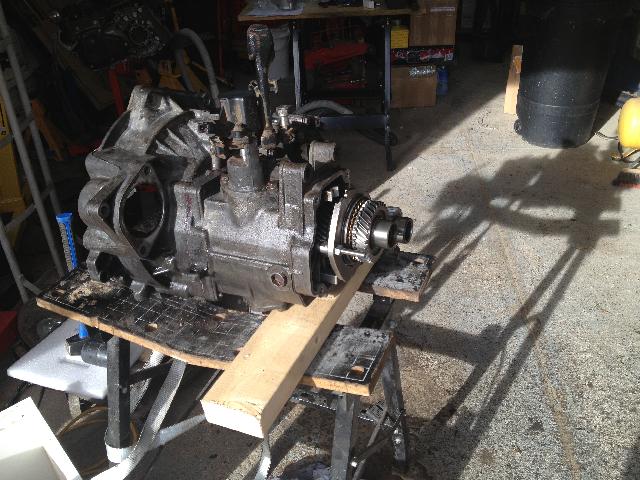

Having just installed one of these, I can say it's a nice piece of kit.
In the stock 02A/02J, 5th is closest to the transmission, the synchros and selector hub on the very end of the shafts.  There's a pivot on the shifter so when the shifter pushes out for 5th it moves the selector hub in to engage 5th.  For the Eurotuning kit, 6th is inside, 5th is outside.  ET removed the pivot so the shift pattern is maintained.  Figuring that you'll spend most of your highway time in 6th, having 6th on the original shafts should keep things stronger.  Smart, that.  The kit replaces the stock 5th, giving you something to sell to the gasser crowd.
The kit installs easily enough, I had the trans on the bench so I pulled it apart instead of the pseudo-laparoscopic method keeping the trans in the car.
The gears used in the kit are nice and heavy, seem to be either modified OEM parts, or parts modeled off OEM bits.
The kit is infinitely superior to the VLEnt Option6 020 6-speed kit I had years ago.
The 02S is the factory 02A based 6 speed, but there aren't any diesel friendly gearsets, as far as I know.  Additionally the 02S seems to have the ratio for 6th about the same as a 5spd would be, with 1-5th being geared closer together.   The Eurotuning kit gives you an additional overdrive gear.
The tranny I built is a CTN transmission from a mk3 TDI.  It's a 3.16 final drive with a 0.76 5th as delivered by VW.
I opted for the tall kit from ET, 0.71 5th and 0.59 6th.
The trans went into my Rabbit pickup behind a mk4 ALH TDI.  0.205 injectors, rocketchip stage 3, dyno'd at 149WHP.   I'm replacing an oddball 020 transmission with a 0.71 5th and VW Motorsport 3.42 R&P.   After ~250,000kms on the swap the clutch was giving way.  It had been slipping under full power for a very very long time, but given I was driving 275+ torques on an 020, I'd rather the clutch slip than the trans explode.
I built my own mounts for the 02A, installed a cable shifter, and used a cable clutch adapter with a Civic clutch cable.  G60 flywheel, VR6 clutch.
The 02A+6th gear housing is shorter in length than the stock 5spd 020, so no body modifications to make it fit.  On my mk1 GLI I had to modify the inner fender to clear the Option6 kit.

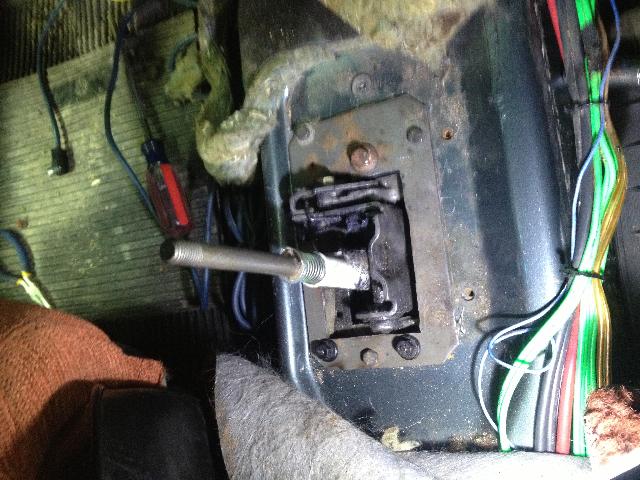

I installed the shifter box under the tunnel.  The shifter is very low, and I mixed up and mounted it too far back, so 2nd gear hits the driver's seat.  Once spring comes I hope to install an 02J shift tower and shifter.  It should raise things up a bit, and improve the shifter over the 02A.
