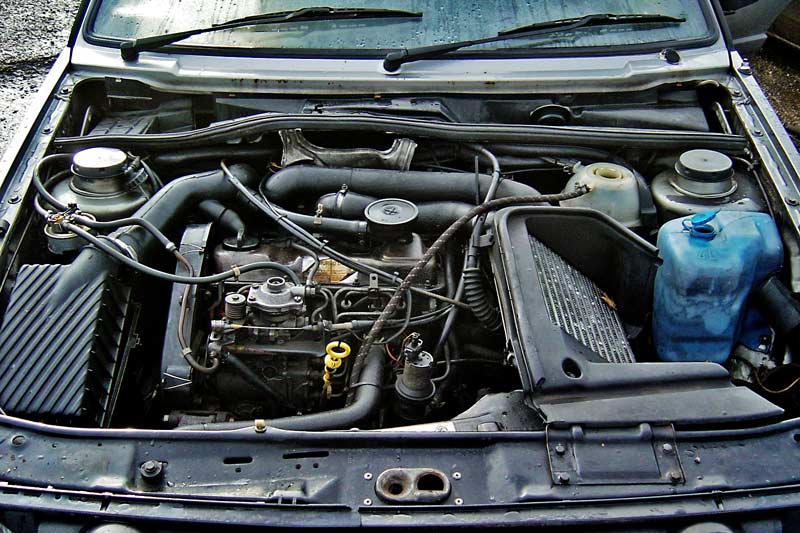

Hey guys... Firstly, i'm new to this forum, and indeed diesels :) so excuse me if i sound like a novice :D
Anyways, i currently drive a 1.6D caddy, and recently spotted a GTD in our local scrapyard. It had just come in, so it hadn't been touched. It took a bit of bump starting (the glow plug light didn't come on, and the engine turned but didn't start off the ignition) but once it got going it ran pretty smooth, so i took it for a drive around the yard, lol.
I decided to buy the engine and 5 speed box for a conversion on the caddy. It's done 150,000 miles, and the whole car looked stock with no mod's or messing about with. I know i have to have a custom downpipe made, but as the engine will be out of the car over the winter period (looking at getting it into my caddy in march '06) then i though i better attempt a strip down, and rebuild, so that i get the best out of it once it goes in.
So guys, what sort of things should i replace or upgrade? and is there anything i could do to the engine that would give it more power?
Cheers for listening guys... heres my caddy, and the engine before i took it out of the donor car:

Where do they put the battery on a GTD???
I don't see it, or it was removed prior the picture was taken. :arrow:  :?:

Look at the wipers. Notice they are on the wrong (right) side?
Not on the caddy, but on the GTD...
He's (maybe she's, it says Rachel on the website provided) from Great Brittain, south Africa or Australia/New Zealand.

I'd give anything  for that intercooler and tubing. Anyone need a left nut? :shock:
