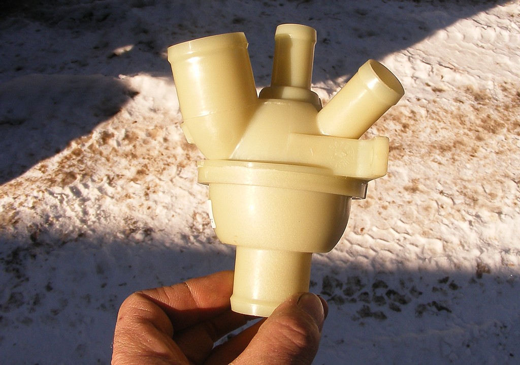

I think I might have figured out the problem. The cooling system design. I think the system was designed to work in a certain configuration, and not having the engine in a VW, I no longer have a configuration that will work within the designed parameters. The thermostat is on the cold line, so hot and cold water have to mix. I think my system has too much capacity and cooling. Since my cold side doesn't get hot, the hot side has to get extra hot to be able to blend down to the opening temp of the thermostat. To fix this, I am going to put a remote thermostat on the hot side and take out the stock thermostat. I found I run a little cooler by completely pinching off the bypass hose, and just having the bypass water through the heaters(which are currently my "radiator" as the thermostat never opens much) the thermostat I found has a bypass that gets blocked off at temp, in and out, and a heater hose port, so should be relatively easy to retrofit. The only downside is that it is permanently encased in plastic, but is only $25. I believe this will fix all my heat problems. I get it tomorrow, and should have it on by Saturday, so I will let you all know how it goes.

Got the thermostat today. Letting the car cool down, then in it goes  ;D

That looks like my air manifold that I put in my oil system...only plastic and not threaded. Will you show a pic when done. Also some of your ride. I am thinking of building one only keep it IDI.

WOOT!!!!!! I just got back from my test hill, which with the stock thermostat I would be up to 230 by the top. The temp climbed to 195, stat opened and the temp dropped to 180 and stayed between there and 190, all without my fan coming on.
As for my ride, I have pics here http://www.66rover.com/mods/mods.html, although you may have seen them from back when I was on the board a lot. I don't know that a pic of the thermostat mod will help as you can't see enough as other things are in the way. What I did was cut the upper hose between the engine and radiator and put it there. I took the stock thermostat completely out I plugged the bypass hose coming from the head, although some day it will get a fitting without a bypass. The slightly smaller fitting on the very end of the thermostat, opposite the radiator end, got hooked to the bypass fitting on the water pump. The slightly larger fitting on the thermostat went to my second heater.
Reply #24December 10, 2011, 04:12:06 pm
Re: Thermostat
« Reply #24 on: December 10, 2011, 04:12:06 pm »
BTW, the thermostat is off of a P38 Range Rover, year range of around 2000. I got it from a local shop for $25.

i believe replacing his thermostat with the one pictured, solved his problems...

That is why I bumped it. I will probably use this thermo deal in the Heep TDI I am building.

try to keep the t-stat in the original location first..
the original location is actually very good..
