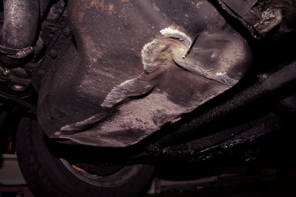

it's a hydraulic 1.6 TD, and it's running diesel-formulated 15-40
would this possibly have anything to do with my oil pump?
how easy is it to damage them?
say, if my oil pan looks like this?
Reply #9April 09, 2011, 12:21:25 pm
Re: Lumpy at idle & increasing rpm
« Reply #9 on: April 09, 2011, 12:21:25 pm »
you gotta bottom out hard to make an oil pan look like that.. trust me, i know exactly how hard it is to get a dent that big.
i doubt you harmed the oil pump tho, its in the half round recess in the oil pan, and that part of the pan appears to be un-crushed.
may have bent the pickup tube, but thats it..
Reply #10April 09, 2011, 09:18:41 pm
vanagonturbo
  • 639
    • Fine Tuning
« Reply #10 on: April 09, 2011, 09:18:41 pm »
Umm, if your oil pan looks like that, STOP DRIVING THE CAR!!. In the pic shown, if you know where the oil pump pickup tube is, you can see its outline in the pan. Not good. Restricted oil flow causes all kind of bad things. Dont ask me how I know :banghead:

so yes, the sound was from a lack of oil :-[
i pulled the pan and replaced the oil pump/bent up pickup tube with a high-flow pump, hammered the bend in the pan back out and made it flat on the bottom (to aid in ground clearance)
then put some oil thickener / moly lube type stuff in and it runs great, no more noise, all the same power, no smoke, etc etc
