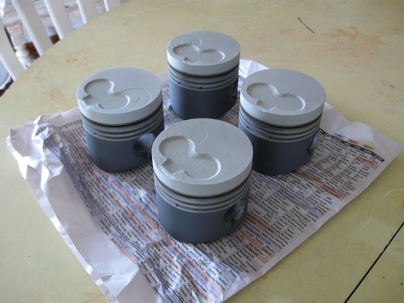

On my wife's IDI, I re-used the pistons that clearly had met some valves in a past experience.  That explained the aftermarket head that was on the engine when I got it.  :P
Cleaned them up, had my machine guy check them out and called them good.  I later had them Swaintech thermal coated with new rings.
Measured the protrusion after installing new bearings, all good so no bent rods.
Still running strong.
