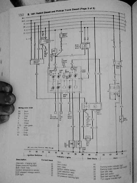

I'll have to spend a couple minutes on my other computer to highlight the exact wires you'll need to look at (this is a crappy laptop web-cam pic) but I've got the diagram from the Bentley manual. If you can get a good picture of where the seat-belt relay should go and the factory jumper bar we may be able to get it figured out. According to the Bentley, the BR/W wires going to the seat-belt buckle are actually both the same power wire and clipping the buckle in opens the circuit and shuts off the light and or chime.
What do you have for testing, multimeter, test light?
If I can explain in words what I'll try to back up with a better picture later, the power supply is as follows;
Batt + > Ign Sw > Jumper bar (in fuse block) > Through seat-belt buckle > seat-belt relay (which closes a separate circuit for the seat-belt light/chime circuit) > Ground after relay
*Note: the seat belt relay is a solid state relay so it won't click like most electromagnetic relays do when the coil gets energized and sucks the armature open/closed completing the circuit*
Reply #11June 05, 2010, 12:10:36 am
Baron VonZeppelin
Re: Mk1 HOW? Want my seatbelt dash light to come on if belt not fastened.
« Reply #11 on: June 05, 2010, 12:10:36 am »
PM me your email addy and i'll send a pic by email.
My ISP is turtle-charged and doesn't do worth a hoot with pic host sites at all.
I have a test light, and a 2 lead multi-meter.
But not exactly well schooled with the multi-meter.
