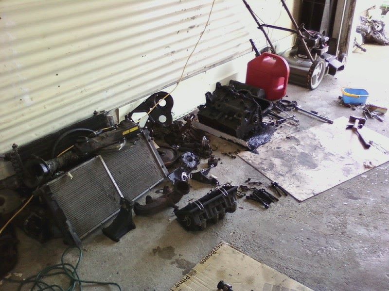

Pile of junk that all eventually needs to find it's way back on the car:

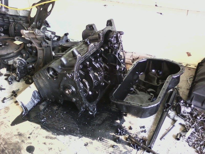

And the bottom end:
Everything looks really good in there.  Rods and mains are all tight, I did find out why it had an aftermarket head though- there are valve indentations on all of the pistons.   :roll: No big deal.  I'll have the machine shop give them a quick skim.  If it's in the budget, they will also be Swaintech coated.  There was a lot of oil on the #4 glow plug so I'm going to assume that was the cylinder that was not sealing properly.
