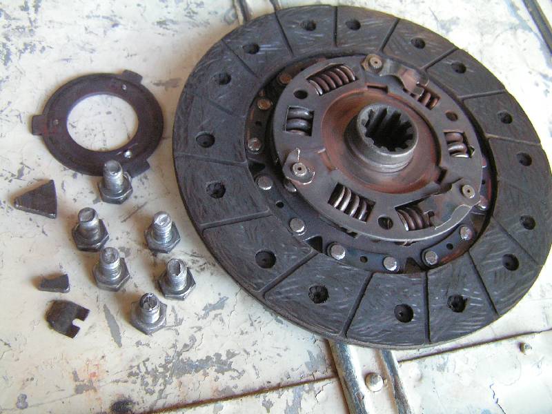

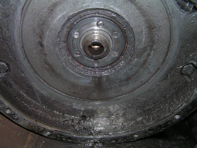

First pics from tranny removal.
The 6 sheared bolts and broken clutch disc and pieces.
The rest of the bolts in the crank. I sure hope they come out ok.

:shock: looks like it's salvagable!  damn that thing must have been screaming !!!!!

So you stopped then engine by dumping the clutch in gear? Good thing the engine died after the flywheel bolts sheared off. I think you should pull the cam plate out of the pump and measure the lift to see if it got worn down and maybe the cam rollers too.
I guess it's good to know the weakest part of you engine is the flywheel bolts!  :lol:

Actually they sheared after the engine stopped, I reeouted the air hose and I started driving again. I had to buy bolts as the VW ones were too short for the Toyota flywheel. I had 8.8 in it, but will be replacing with 10.9.
Ah-ha.  I was going to say, I've never seen that happen in a VW before.  :P  I'd probably try and find some ARP bolts that are the right size if it were me.

Someone brought up a point that I hadn't thought of before. I had problems with my idle slowly increasing over time. It would idle fine when first started, but would then increase after a minute or so. It may have been due to some oil getting sucked through, kind of an unheeded warning before the final catastrophe.
Got the broken bolts out very easily with a left hand drill bit, and luckily the crank seems fine. Now to get $ for the turbo rebuild and new pressure plate and clutch disc and whatever else.(hopefully nothing...)

I never saw those bolts broken like that. Maybe you should get some nice heavy duty bolts for that. It looks like they couldn't just hold the torque and passed out due to stress.
I'm glad it wasn't that serious at last. Just a bit of extra work and it's on the road?dirt? again.  :)
