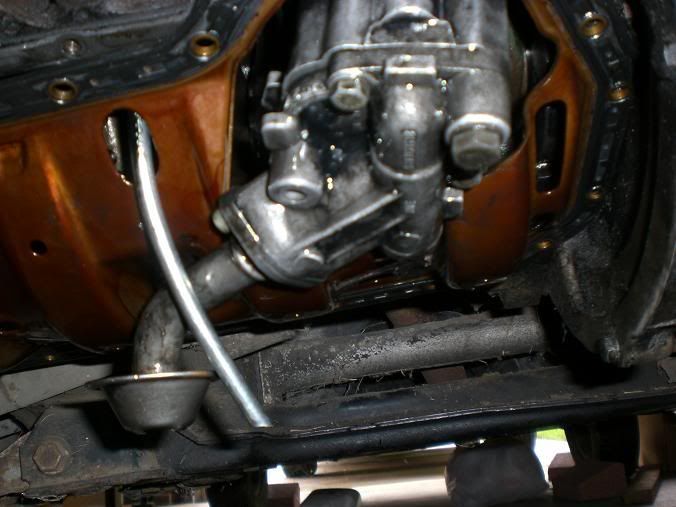

Windage tray goes in, cleaned out all the hair  :shock: from the screen of the oil pump:
