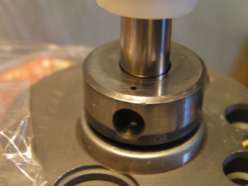

Another tid bit of info.
If your pump head has recessed areas where the springs sit as in the pic jimfoo posted does and your old pump didn't have then you need a new spring kit as well..
The 2 large springs is what I'm talking about, where they sit in/on the pump head.
